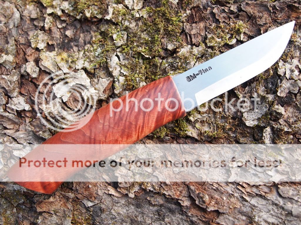

    I agree with Lil Red. First I clean the wood with alcohol to break down any grease left by my fingers. I then apply the stain thinned down with thinners or white spirits first. I think many people make the mistake of trying to go too heavy with the stain the first time around. Make several light layers and darken according to taste. When you get to the right shade you can stop. It's much too difficult to get it right with one thick coat. This is the technique I used with this knife:
    I prefer lighter shades as the darker you go, the more it obscures the beautiful features of the wood. I used 4 coats of teak stain and I finished the knife with 5 coats of danish oil.
