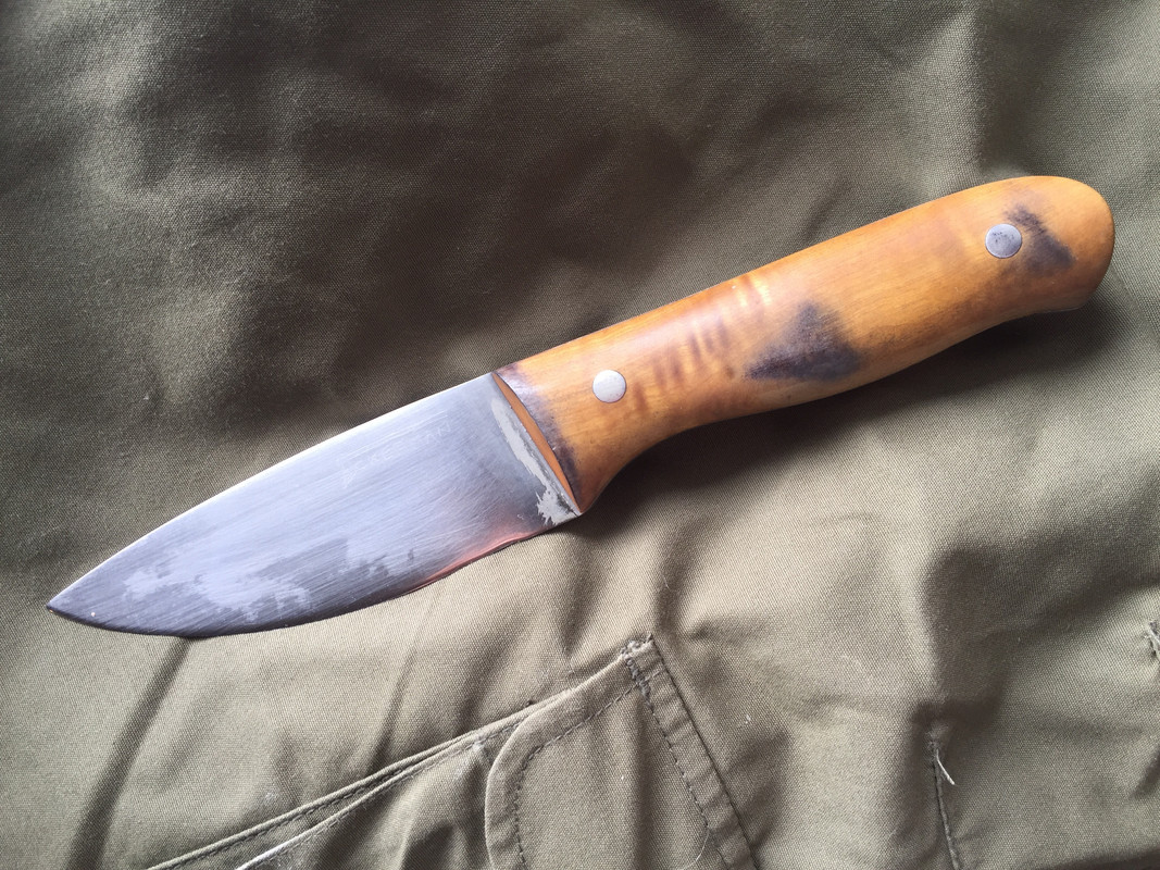

I posted this one in cast 440C & Sneezewood over on Fixed Blade Friday yesterday:) Use it a lot. It goes against the philosophy of the material, but I put a convex on it. It is a wonder.

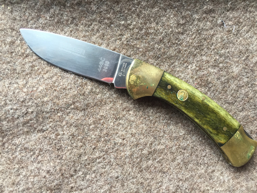

Here's another one that periodically gets used a ton. Bought it in 2006 after seeing one on a camp/walk trip in Netherlands. Again, a convex edge really seems to suit the 440C. Dead easy to maintain by stropping on denim after that, and lasts a good while. The brass makes it weigh something like half a pound, which is a lot for a folder, big as it is
