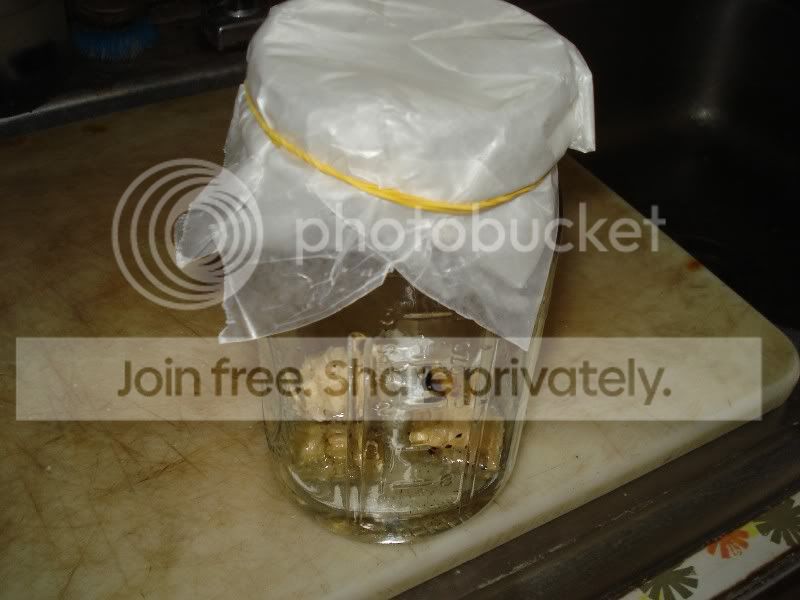

I put an inch, or so of lighter fluid in a Mason jar, dropped in some of the cob pieces, and covered the jar with two layers of waxed paper. I didn’t want to seal the jar tightly, because of the volatile fumes. I hate it when I blow myself up. :p
I let the cobs marinate for 48 hours. Then I pulled a couple out, and set them on a paper towel to drain. After about 30 minutes, I attempted a strike test with a ferro rod on one of the pieces. After 30 minutes of air drying, it still retained good combustion qualities.

Conclusion? Way more trouble than it’s worth, unless you want to keep a jar soaking in the kitchen to use on a regular basis. Pull them out, shake ‘em off, and they’ll burn like a candle in your wood stove, and start even coarse kindling. As far as something to make, stick in your pack, and save for a rainy day, there are many better options IMO.
