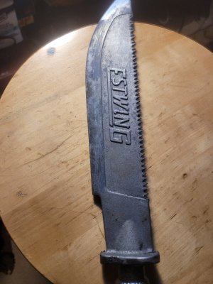

My machete arrived today. It's a beast. It's definitely in need of a tuneup. The blade is coated with what looks like enamel? I'm going to try some paint stripper on it and see if that takes it off. I think that will make a huge impact on the performance. I haven't used it for anything yet, but most likely will tomorrow. I'll drop some pics.

I did a little messing around tonight and found that the finish on it fairly easily scrapes of with a utility knife blade. Go figure. :)

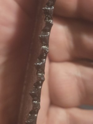

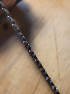

I also noticed that the teeth on the Estwing side have a good set, the USA side not so much. I have a plan to fix that. I'll get pics when I do it, whether it works or not. 20250918_225320.jpg20250918_225323.jpg

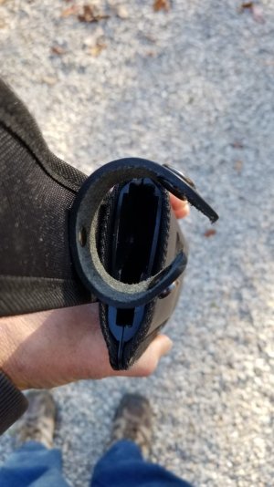

For the money I think the sheath was pretty good as well.

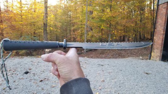

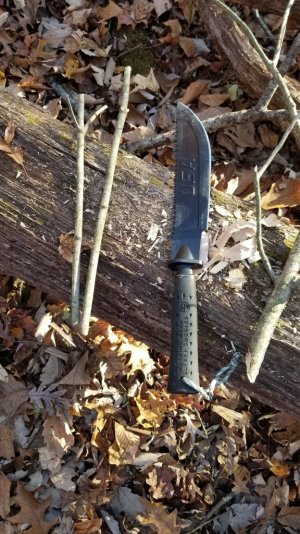

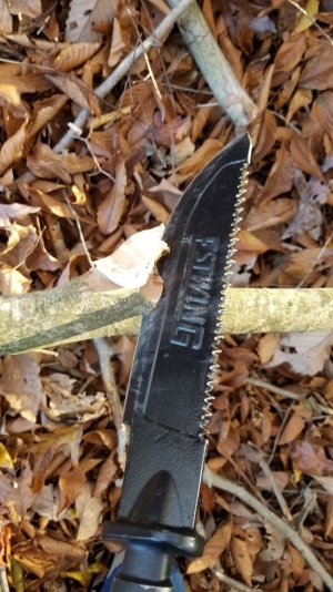

I beat on it pretty good I have more pics somewhere but found these and figured I'd share

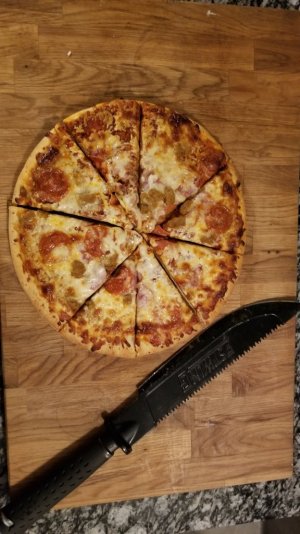

Slices pizza well lol.

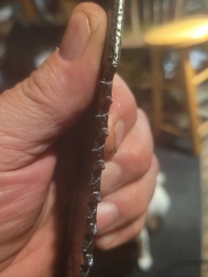

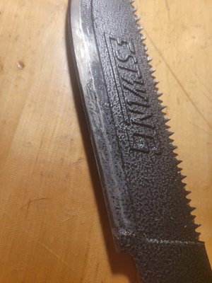

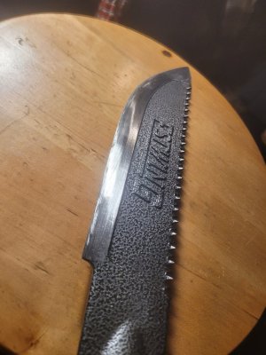

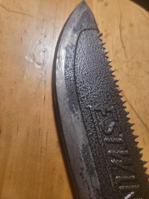

I took the rest of the coating off the cutting edge today, and gave it a pretty decent convex regrind. Honed it with my diamond stone and it's got a pretty respectable edge now. I'd happily use it to carve a ham or turkey. 20250919_200530.jpg20250919_200542.jpg
I'm going to soak it in citrus strip tonight and see if the saw teeth come clean. I didn't do anything with the set of the teeth yet.
I took the rest of the coating off the cutting edge today, and gave it a pretty decent convex regrind. Honed it with my diamond stone and it's got a pretty respectable edge now. I'd happily use it to carve a ham or turkey. View attachment 2183886View attachment 2183887

I wish the link worked to the pass-around thread. We had a good bit of discussion about the set of the teeth.
When I checked the kerf width by measuring the width from left hand teeth to outside of right hand teeth, and then checked the thickness of the blade stock, I came to the conclusion that I would not be able to reduce the set of the teeth without causing the blade to bind in the kerf. Hope that makes some kind of sense. Let me see if I can find the thread again and copy over a couple of my posts.
Yep. I think you nailed it. I've had that comment bouncing around in my big hollow noggin all day and just got down to the basement to check.
0.165" or so across the teeth (I checked several places, pretty consistent), and about 0.170" behind the edge. Not quite 3/16".
So, if you ever completely buried the blade, the kerf would actually not be wide enough for smooth sawing.
And as you pointed out, you can't make the blade thinner without sacrificing some of the weight, which provides the chopping power, which is where the tool shines.
But, the teeth could still be better executed. Looking at the pictures from before anyone sharpened the teeth, there was an obvious lack of effort/thinking/knowledge at the factory.

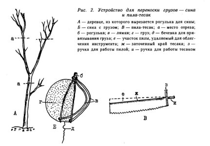

This machete reminded me of the tool of the rangers of Eastern Siberia and Transbaikalia. It was made from half a two-handed saw. It could be used as a cleaver and for cutting down small trees.

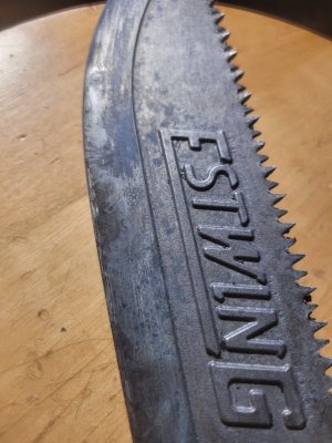

Citrus Strip for the win!

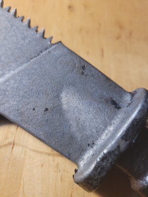

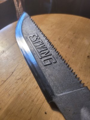

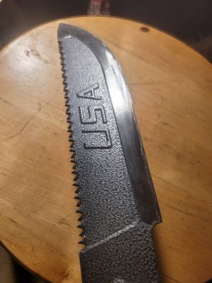

I soaked it overnight and this morning the finish just wiped away. Just a few tiny spots left. I think it's much more attractive now.

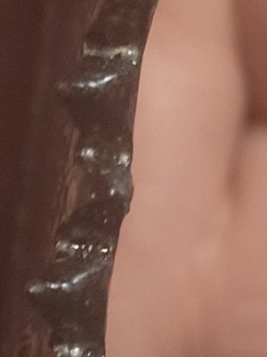

It did darken the edge that I had cleaned up. A few minutes with my dremel and a drum sander and it's cleaned up. I brushed the saw and you may be able to see the inconsistencies in the tooth set. I'll work on that next. In the meantime, I'm going to give it some stuff to chop.

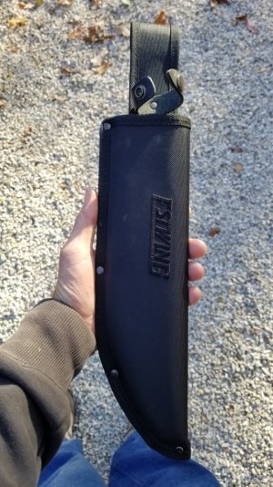

It appears that the sheath that came with this is a better design than the original.

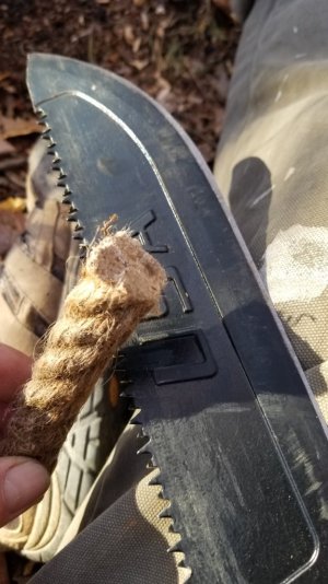

I'll get the sawback tuned up in the near future. It'd not a real high priority on my life list right now. :) I didn't buy it for it's sawing capability. However, knowing my mo, I'll probably be taking a file to it in the next couple of days, if not tonight. :)20250920_121023.jpg20250920_121027.jpg20250920_121030.jpg20250920_122029.jpg20250920_122054.jpg

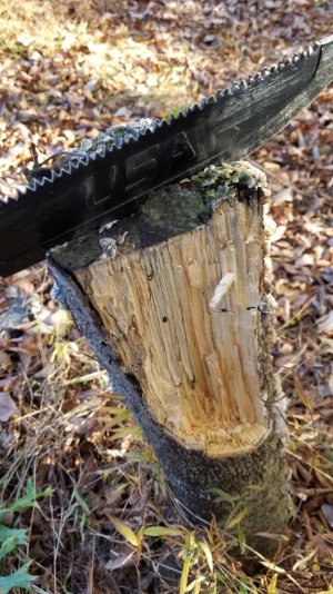

I took it out for a spin tonight. As expected, the sawback is pretty useless. :) I think a jagged rock would cut faster.
The machete chops nice though. Impressive. With the thicker blade and convex edge, it's not slick like a typical machete. But it throws nice chips. It's actually more like a hatchet with a really long cutting edge. :)
If I didn't have so many other things going right now, I'd buy another of these and put a hollow grind on it. I bet it would slice and dice then. 🔪🗡️
