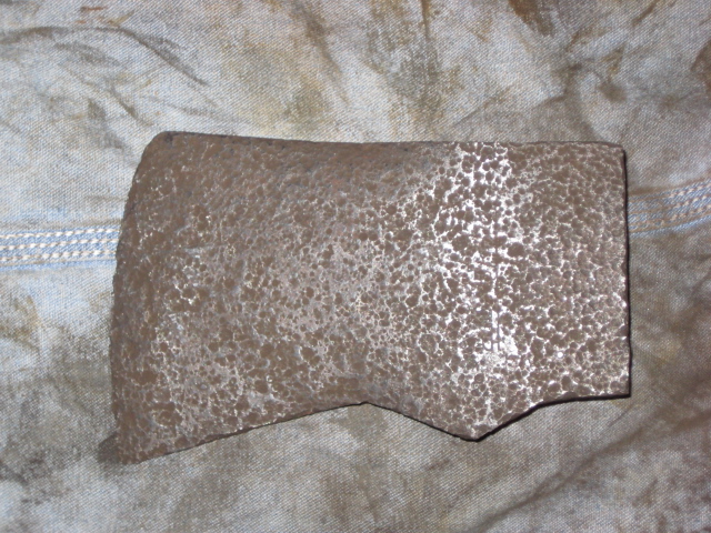

this is after 5-6 hours. i'm going to put it back in tomorrow weather permitting.
this partial mark wasn't visible before but is too far gone to make out.
It's actually looking really good! I might stop there though, the residue rust is kind of a pit filler of sorts. Any further and you might have the surface of the moon on your axe. Keep us appraised for sure, and nice work with the electrolysis.

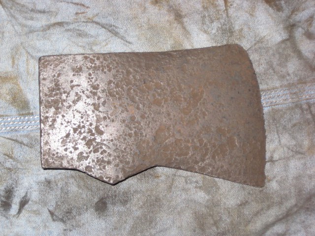

electrolysis is complete. still not sure if it's salvageable but i'm going to finish cleaning up the head before handling it. one side has lots of shallow pits the other has a few deep pits. the maker mark is a little more discernible now.
Looks like a Kelly True Temper makers mark. They run a line over their logo as pictured below. There is some variation in their mark, as it doesn't always read VULCAN or KELLY WORKS. It's a good axe, and a Jersey Pattern. It does look VERY serviceable. Keep us posted.
