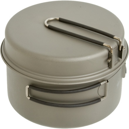

I'm looking for a combo set up like these two:
Backcountry.com Titanium Cookset - 1650ml:
Or the Snow Peak Trek 1400 Aluminum:
Would prefer something in stainless steel. I'm not completely overtaken by the aluminum boogymonster, but I'm getting close.
Anyone know of something in that sorta ballpark that I won't spend an arm and a leg on?
