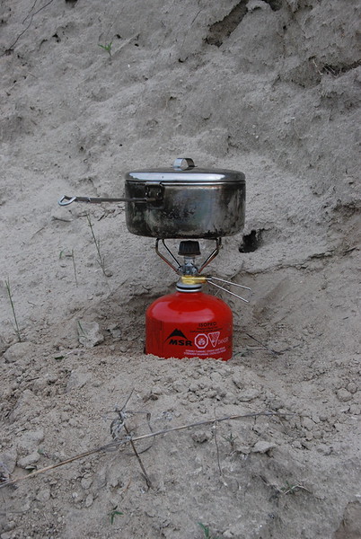

This is a bit silly, but maybe also helpful. Last year I bought one of those little backpacking stoves that uses isobutane canisters (Snow Peak Gigapower). Been using the stove quite a bit since I bought it to test it out and get accustomed to it.
I should note I've been using a 200g canister so far.
The stove's first burn was on a camping trip on April 30, 2011. (Didn't take pictures of it doing any cooking)
I have no idea what the actual burn time for the canister has been, but it finally has gotten empty enough that it won't boil water in mid-20-degree weather any more. In warm weather I bet it'll still have a couple burns left in it but I had to break out a new canister while making some tea and easy mac on a hike this afternoon.
In short, I'm pretty dang impressed with this little stove and the canisters it uses. This canister has been in use for about 8 months. The stove and canister have been used for things from simple boiling water to making eggs and sausage. I haven't gotten to anything fancier, but will probably try some more stuff with it in the next year.
Here are a couple more glory shots:
