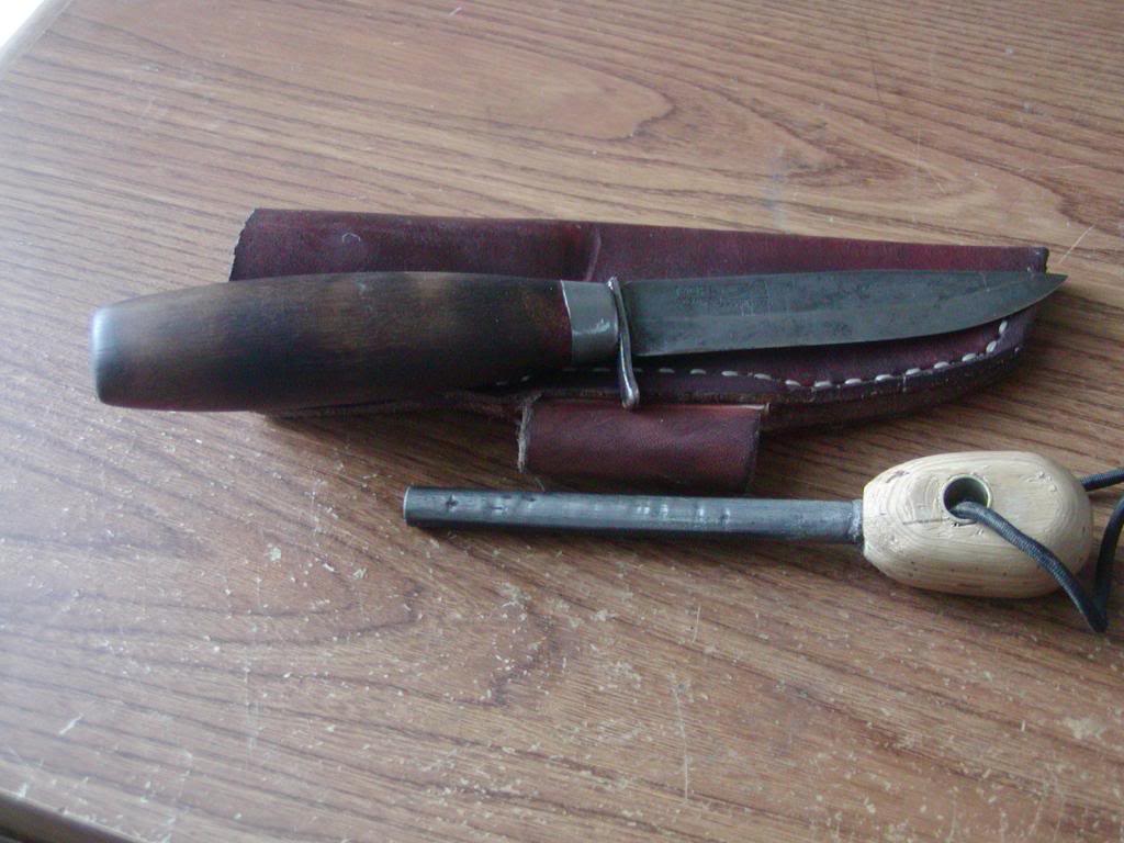

I've tried the last couple years to get into the Mora, woodlore, you name it fixed blade that has from a little bump to a large curve as a "guard." And I really like the kephart clone I made. But if I was really out on an overnight wilderness adventure,
I just can't see it. Or get totally comfortable with it. Maybe its just me and my 1911 thumb and grip safety vs a glock safety upbringing.
I know there are a lot of good gardless knives but I can't see them as much more than an accident waiting to happen. Good for a lot of cutting tasks but if I was really out in the wilderness, slipping my dominant hand down on a sharp edge and cutting it badly would be really bad.
I don't think a modest finger guard ever got in my way. But I have been cold to the point it was difficult to keep a good grip on things, esp a small nail to adjust the front sight post of an m16a1.
IDK, just thinking about it while it's frozen outside.
